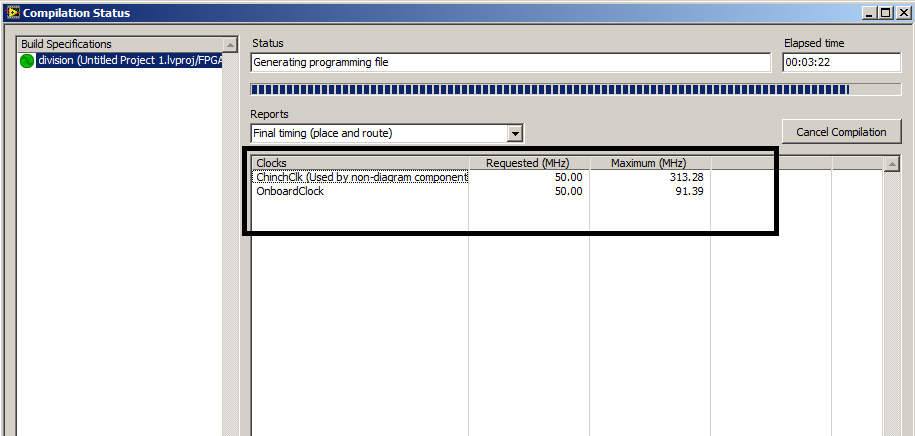

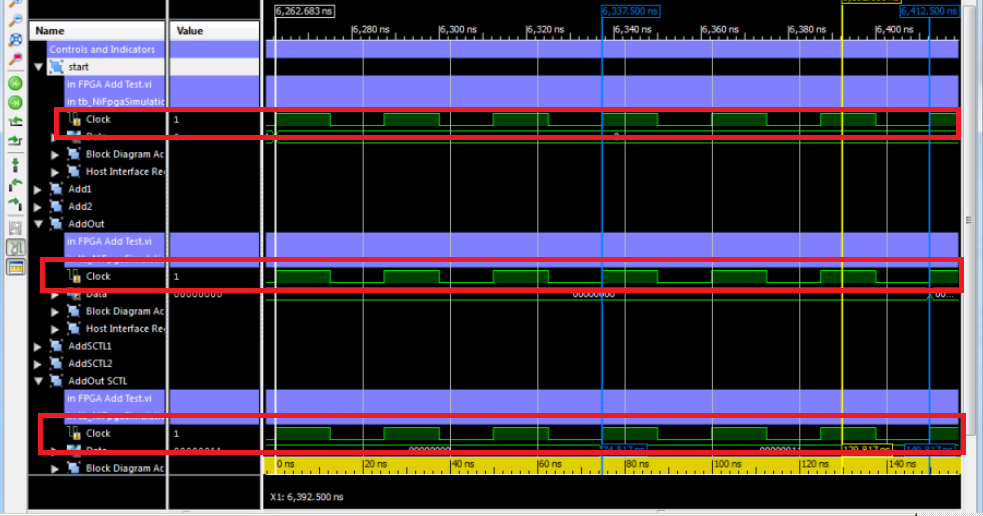

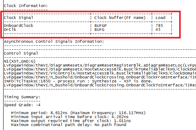

I have main  problem  with LABVIEW FPGA and not solved until know which it as follow
when I need to build system in FPGA in  xilinx ISE their a single clock and depend on this clock I will synchroniz the adder and multiplier and other elements using  vhdl  code so depend on my code this clock will have maximum frequency value and during simulation their is an single clock I can see the change.
But when I work on LAB VIEW FPGA no single clock appear and many clock source appear
for example
in compilation result you can see two clock
And in xlinx log you can see two clock
And from this http://www.ni.com/white-paper/12942/en
you can see three source
please expain to us what is happen !!!!

Hi mangood,
Could you post the VI? I would like to see how you are specifying the clock signal in the code.
steve.bm
AE | NI
(2,483 Views)
dear
i take the vi it from here
please itract me
