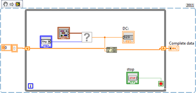

If complete data  at the end is required use shift register as shown below

When I run the vi, I want to collect all data. But in the example, data does not came to the part of DC.  In my opinion, there is a loop inside loop for that reason it doesn't work. If I save for this case, may be it can work.

Your question, intent, and VI are not clear. The VI you uploaded contains a single loop that calls a subVI that you did not include. I don't know what you mean by "green" in the example. You also did not indicate how you are collecting this data. It appears to be via a serial connection. The Build Array method shown in nijams's example is not necessarily a good method since it continously builds an array, which causes memory thrashing.
