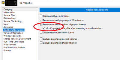

If the program works, I guess it doesn't use those functions. Are the build settings excluding unused project libraries members?

IIRC, the class responsible for Excel is loaded dynamically (internally), and it is not included automatically.
I think this covers it https://forums.ni.com/t5/LabVIEW/EXE-with-Report-Generation-Toolkit/m-p/3844024#M1087958
Another option is to simply find the Excel RGT class and use that instead of the open report VI that uses the report type enum. The enum will dynamically select the report type, and this means the compiler for executables won't include the child classes, as it has no idea that it should.
