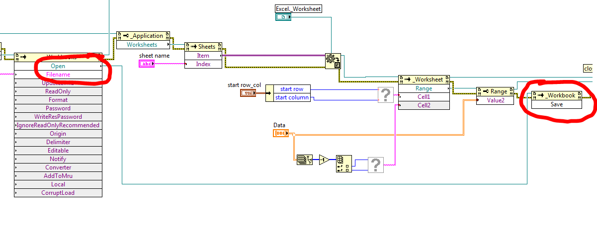

I want to write 2D array to specific colums/rows in excel
Also, since you decided to make the application not visible, you will have to save the workbook after writing the values to the range but before closing the application reference .  If you don't, the workbook will be open in memory but not accessible.  It's also good practice to close all references when you are through with them (i.e. worksheet, range, workbook, application, etc).

I've added a "Save Workspace" node but still get an error after the Worksheet->Range invoke node

You need to save the opened workbook....not the workspace.  And you need to change the "start row_col" values to 1,1 as 0,0 is not valid in Excel.

thanks, i got it working the way i want execpt for one small detail.  I hard-coded a path with a file name in it but it keeps opening a dialogue box asking me which file to open, any clue as to how to remove this?  Again i am going to be calling this VI from TestStand so I don't want to have to select a file each time it opens.

Remove the File Dialog vi at the front of your block diagram.  That VI prompts you to choose a path everytime it is called.

thanks everyone for the help, got it working
