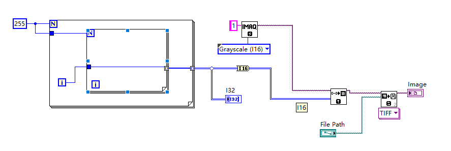

I16 bit tif image can not read in ImagJ correctly.
As you see the program below. I have saved a I16 tif image.
When I use ImageJ to read this tif image, the image is not I16. In fact, the I16 image saved from IMAQ convert to U16 image in ImageJ automatically.
How to save a I16 image which can be read by ImageJ correctly ?
Thank you very much.

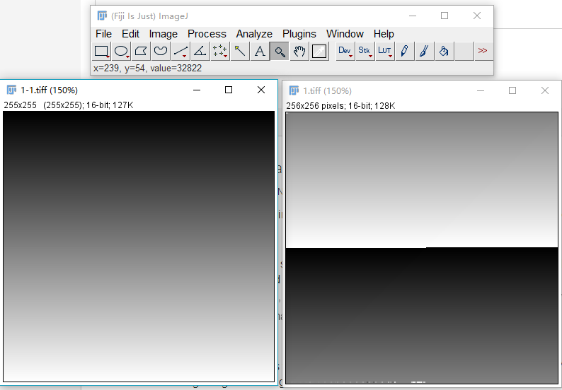

Thank you so much for your help.
I've tried this method before but it does not work. The image information is incorrect.
On the left is the image that opens directly and on the right is the image Raw - import - I16.
