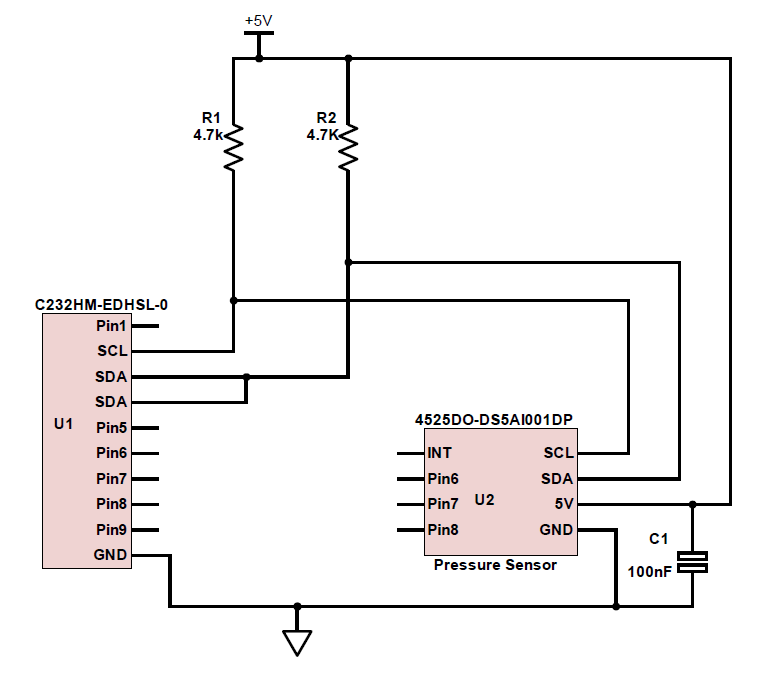

I have a TE 4525DO-DS5AI015DP pressure sensor.  I supply 5V from a tracopower 5V supply and have two 4.7k pullups resistors connecting SDA --> 5V and SCL --> 5V.
I try to talk to it using the FTDI 3.3V I2C device which is also connected to the 5V pullups, (this is fine according to FTDI).

I did a quick schematic of the implementation.

According to the manufacturer datasheet, the base address for your package in I2C interface is I = I2C (Addr.0x28H)
So to access the device, be sure you use the address 28 in hex format.
