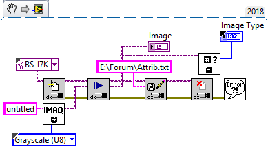

When in doubt, play "Scientist" instead of "Engineer", i.e. "Do an Experiment, Test a Hypothesis".  So my Laptop has a WebCam, so I put together this trivial program that opens an IMAQdx Session, creates an Image Buffer as Grayscale, does a Snap and displays the Image, and also saves the Camera Attributes to a file.  I also ask what Image Type comes out of the Snap.
So I get an RGB Image, even though my Image was created as a Grayscale (U8) (the Image Type reported is also RGB (U32)).  When I look at the text file of Attributes, they appear to be the same as reported by MAX, a small subset of the GenICam Attributes.  I don't see anything that suggests that this particular camera can operate in both B&W and Color -- it seems to be only Color.  [I have another Camera from FLIR that is supposed to be only B&W).
Documentation for LabVIEW Vision is a little sparse, so sometimes "experimenting" can be helpful.  Sorry this particular Experiment didn't yield more useful results ...
IMAQdx ExperimentIMAQdx Experiment
I also attached the Attribute file produced above.
