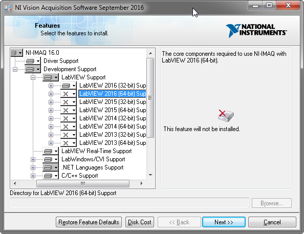

    I need to use IMAQ functions in LabView 64-bit version.  I have the 32-bit version also installed which shows the IMAQ functions and controls.  But they are missing from the pallette in the 64-bit version.  How do I enable them?  Is there a separate software for it?.   I have to use a OpenCV dll which is in 64-bit format.

When you are running the Vision Acquisition Software installer, make sure that you have LabVIEW Support selected as an item to install like shown below
Just make sure the correct LabVIEW version and bitness is set to install.

     Thank you.. Got it solved.. I had installed the 64-bit version after I installed Vision Acquisition software. I ran the installer again with your suggestion and it works fine now..
