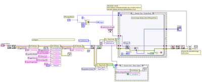

It's a Flir A700 cam.
I figured out that after a camera restart the first image is all black, only zeros.
Actually I just want to send a trigger and retrieve a specified number of consecutive images,
but the first one is old or zero after a camera restart.
