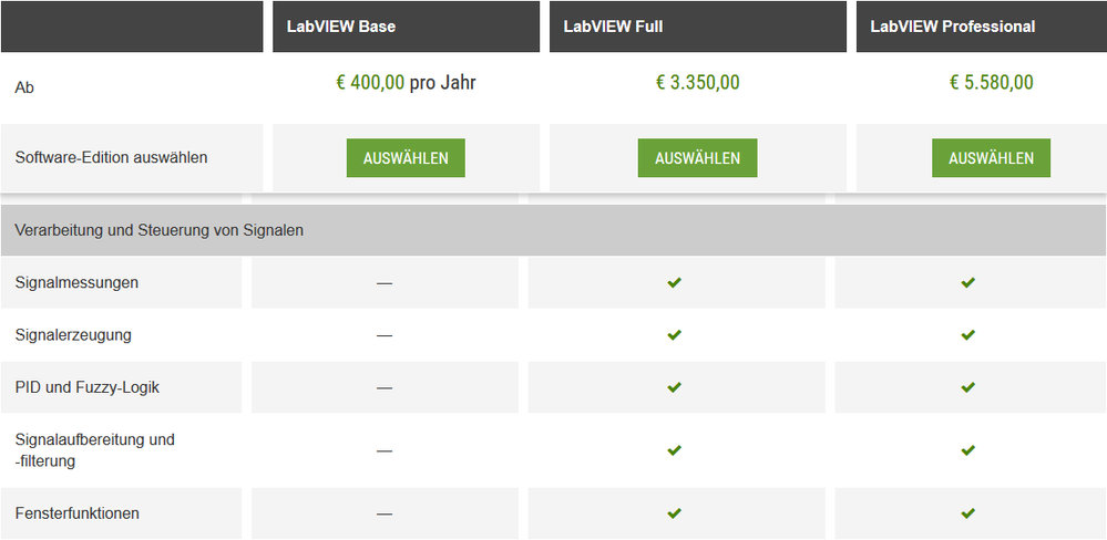

Hi Davis,
@Davis27 wrote:
I Still don't have a firm answer but it looks like I only have LabVIEW Base and would need the full or professional version for access to those VI's.
Why don't you go just to NI's website to compare those LabVIEW "flavours":
(Even though I got the German website I guess you will get the picture.)
Your NI LicenseManager will tell you which flavour is activated on your computer…
