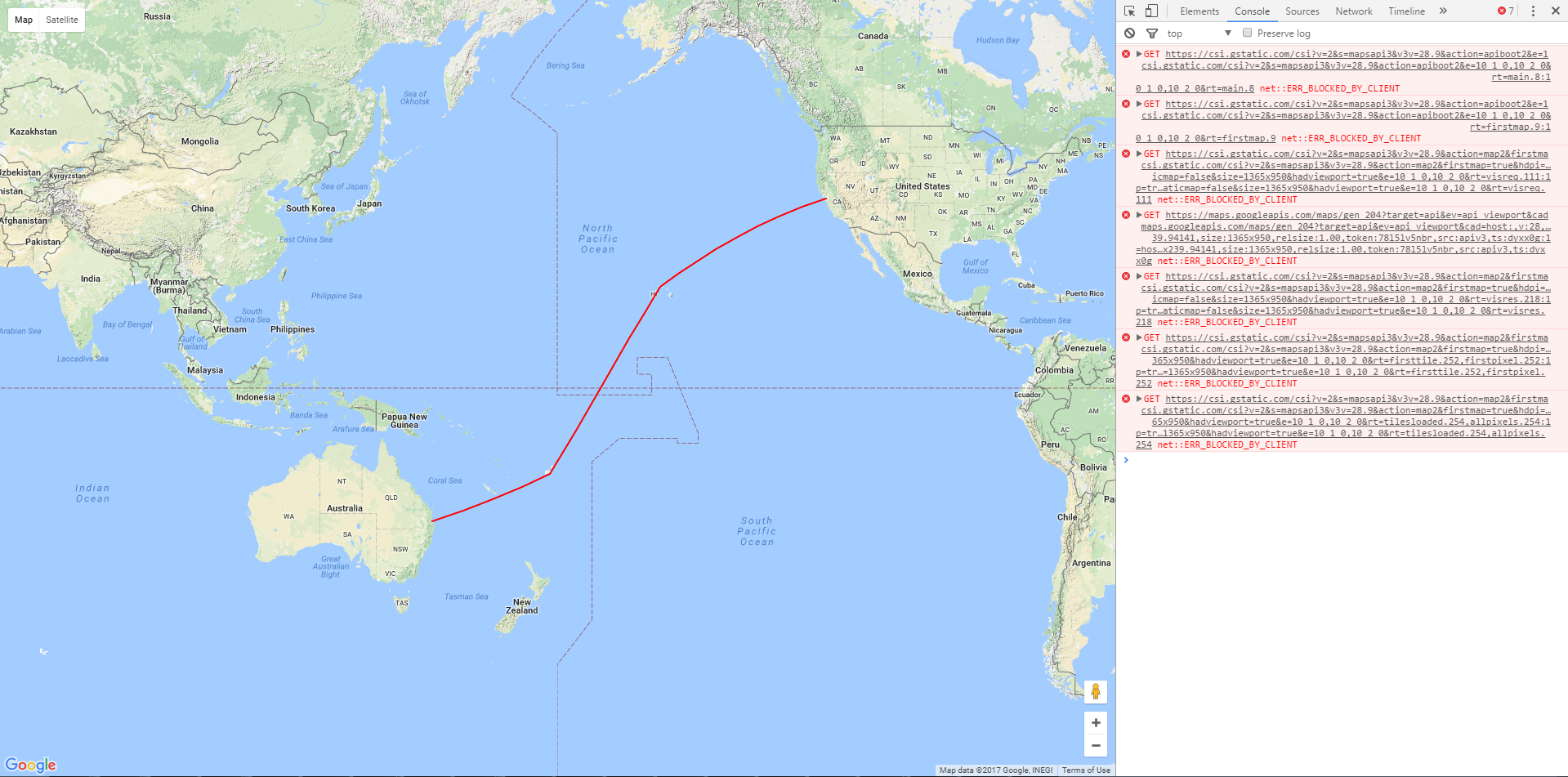

When I open up the script in chrome and open the console using F12, I see some error messages. Could the issue be with Google blocking access to some resource?

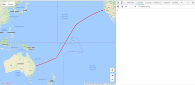

dear SalazarJ,
could you have a screenshot of it? because when i press F12 on it, there is no error on console tabSS.png

The errors in my console tab can be seen below
