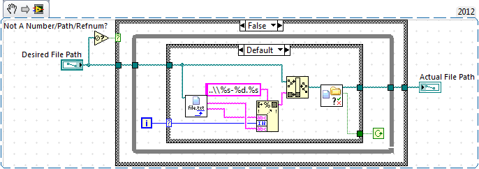

Just to get you started...
The key here is knowing that you will get an error (7) if the file does not exist.  So you will need to add an additional check before this code to see if the file exists.

Accepted by topic author cassidee21
Find the attached prototype (saved in LabVIEW version 2009)
