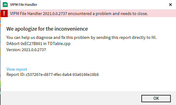

Yes, this is what I mean.
I have VIPM 2020.3.0.2540 which is the latest release and VIPM 21.0.2337 which is the latest beta
In the case on the beta, I get this :

Accepted by topic author TiTou
Found a solution : https://knowledge.ni.com/KnowledgeArticleDetails?id=kA00Z0000019Ru8SAE&l=fr-FR
Luckily, my colleague has the same laptop with similar NI softs installed so he sent me his tdtable.tdr file and then it all works fine again.

Well, the update finally finished and I have no issues with VIPM afterwards (VIPM 2020.3).  I did not need to correct the tdtable.tdr files.  So at the moment, I would have to say you had a weird issue.
