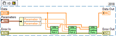

     When you are done (this might take no more than 2-3 paragraphs, and will certainly lack detail), you are (almost) ready to start coding, or at least thinking about coding.  I sat down and in about 5-10 minutes knocked out the following Code:
Top Level VITop Level VIStep 1Step 1
The Top Level VI shows the Data (Array) and the 4 parameters, grouped in a Cluster (to expedite passing one or more of them to sub-VIs).  I showed only the sub-VI for the First Step -- you seem to have 2 or 3 steps in your data processing, each with several sub-Steps.  I also show Step 1, where you use Parameter 1 and the Data to get Data Out 1 (which might be all or some of the Input Data), use Parameters 1 and 2 to get Data Out 2, then combine them to get Data Out.

  • Using sub-VIs allows you to abstract the data processing and concentrate on the inputs, outputs, and parameters, "hiding the details" for now.
  • As you go into the sub-VIs, more details are revealed, but you might still want some further abstraction.
  • Clusters are extremely useful for passing "clusters" of Controls and Indicators around -- keeps things together, and 1 "cable" is much neater than 4 "wires" coming and going everywhere.
  • Making Icons for sub-VIs (and TypeDefs) is easy, and allows you "self-document" your LabVIEW Code.
     Once you've written your Paper Documentation, see if you can recreate some of these sub-VIs yourself and start populating them with code from your Documentation.  Note that at the level I've shown here, the code is still concerned with "What" and is putting off to later the "How", i.e. the LabVIEW Loops, Functions, etc.  Remember, at the lowest level of sub-VI where these LabVIEW "details" appear, you want to be doing "one thing" that you can express in 2-3 words on your VI's Icon.
