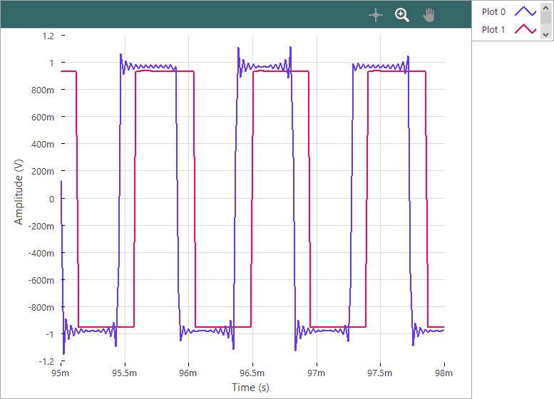

A 9234(DSA) and 9233(SAR) synced together
They are synced together, there is no rolling BUT a constant phase shift between the two.

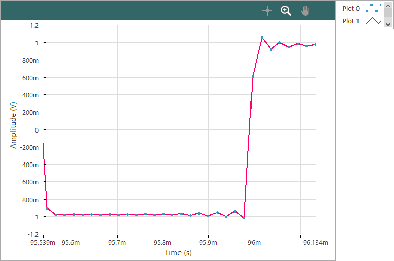

Two DIFFERENT 9234(DSA) and 9234(DSA) synced together, same model but Slot 1 and Slot 3
Synced together. I made one plot only have points otherwise they line up on top of each other

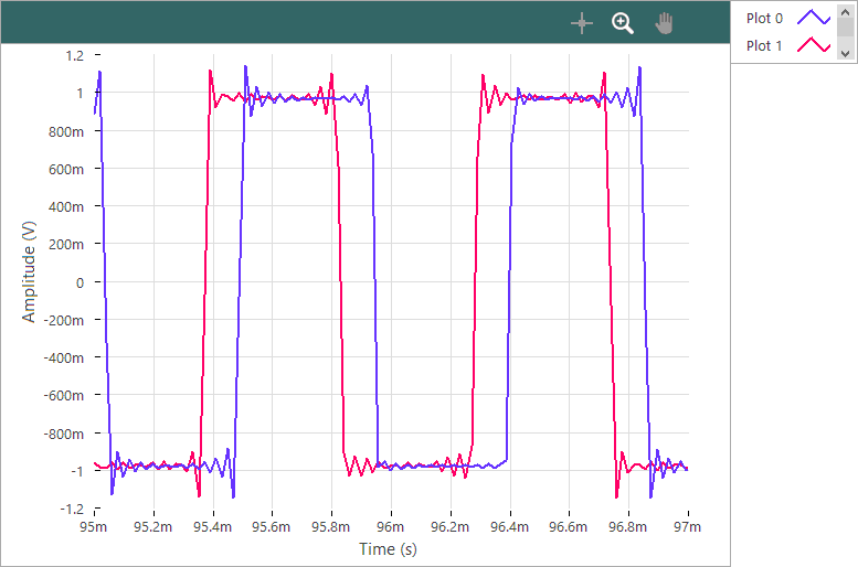

A 9234(DSA) and 9231(DSA) synced together

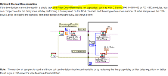

Option 1: Channel Expansion
If the two devices can be used in a single task using Channel Expansion and the devices supports Filter Delay Removal, driver will compensate for the delay automatically. The caveat is that the modules will need to sample data at the same rate.
Using Channel Expansion with devices that don't support Filter Delay Removal like C Series devices, PXI-4461/4462 or PXI-447x modules will synchronize the devices, but will not remove the filter delay.

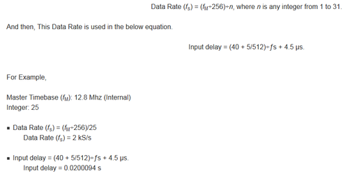

We ran a couple more tests at various Impact velocities at the 50Ks/s rate. And the data lines up perfectly every time as long as I removed .8 ms worth of force data from the beginning of the set.
If I have to, I might try to integrate that delay equation in, so it will work with other sample rates. A majority of the useful data we get takes place in about .1 seconds so I don't need the data to be lined up in a live view, and a post processing method might be easier.
If I can use that equation and feed the sample rate into it, and get a delay value I should be able to look at the time column and count the data points until it reaches the calculated delay time. Once I have this I should be able to cut the beginning of the force data by however many data points and rebuild the data set.

Tidbit: the delay equation is configured to tell you the delay in *seconds*.  You can multiply the whole thing by the sample rate to put in units of *samples* directly.  Then it's:
(40 + 5/512) + (4.5e-6)*sample_rate = # samples worth of delay
