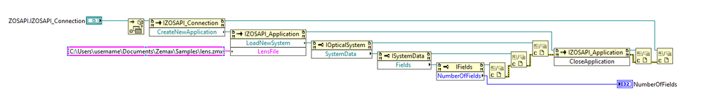

Hi Steffen,
I don't know if you are still interested, but you can investigate using the ActiveX interface. Here is a little sample below:
