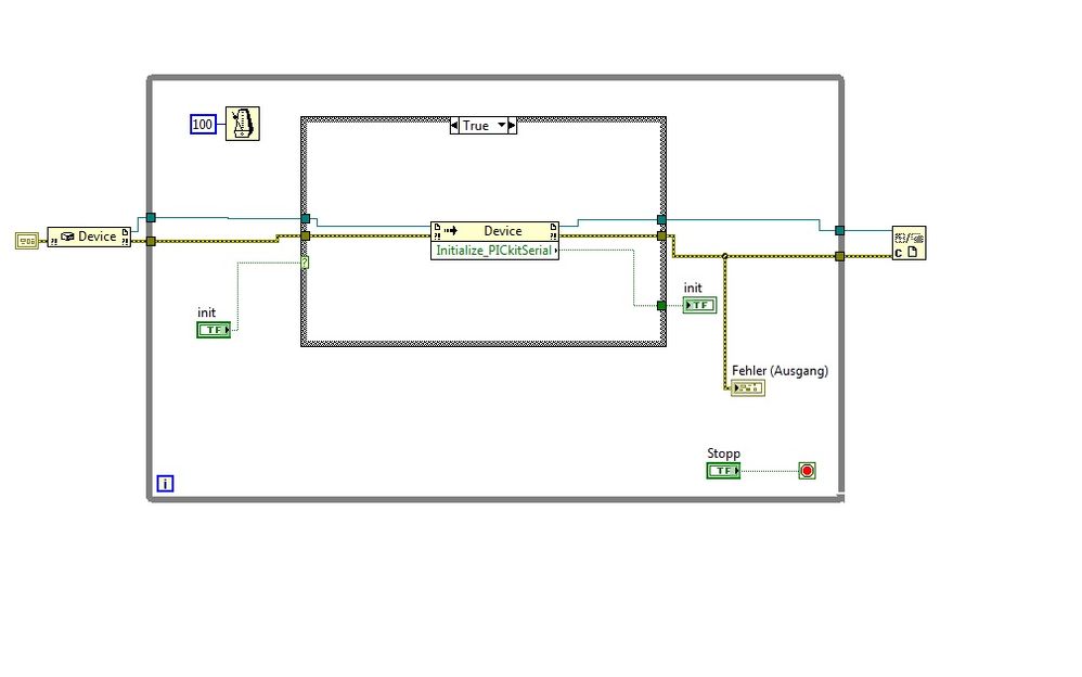

i have problems with the microchips pickits.dll. I would like to implement the dll-File in Labview and communicate with a hardware called LIN Serial Analyzer from microchip.
When I run my Labview VI, it can`t communicate with the device.
This is my composition in Labview which doesnt work.
This composition is created on a WIN7/64bit OS and on a WIN XP/32bit system. Both doesnt work.
The Analyzer runs with the microchip demo application Network Analyzer(64bit).
I have downloaded the LIN Serial Analyzer Update v2.05 (64-bit) from the microchip homepage and with this application it works.
The pickitS.dll works inside LabView correct. When I run the Function Prototype "Get_PickitS_DLL_Version", it returns the correct DLL Version.
Is my composition in LabView right?

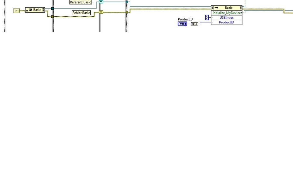

i have solved the problem. For Initialisation of the LIN Serial Analyzer, you have to take the "Basic" Constructor and the method "Initialize_MyDevice" with the parameters USBIndex = 0 and ProductID = 0xA04. With this basic setting you can initialize the device. Following you have to set the baudrate to 19200 for LIN Bus.
Feel free to ask me if you have problems with your device.
