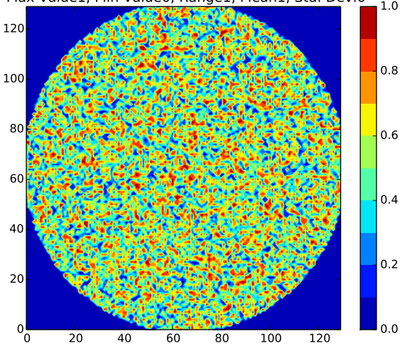

This is the output of the biharmonic spline using the Zeros & Random Values text file.
What I'm aiming for is a 3D model of this.

A snippet with glaring race conditions* and the absence of any data file make any help difficult. Then you show us a 2D picture explaining that you want a 3D model of "this". Way too ambiguous! I have no idea how that would look like!
Instead of a snippet, just zip your VI and your data file and attach it. Then explain exactly what you want to see!
* You are reading local variables (maxRx, etc.) way before their terminal receives any reasonable data. You need to eliminate all locals and only generate the ramps once the values are known, right? Dataflow! Execution order!
