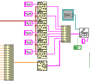

I am using DBL as an input into a 'build array' vi.  I am then doing an 'array to spreadsheet string' vi that then goes to a 'build array' that feeds my 'write spreadsheet'.  I am also time stamping this that is inserted into the second 'build array' that I am using.  Here is my code,  I know it is a little rough around the edges, but it works... lol.  The write to spreadsheet command is in the bottom right corner of the inside while loop.  Thanks for the help.
(2,901 Views)
The extra line is caused by you using an extra Array to Spreadsheet String. This function appends a CR/LF to the end of the string. This function is also inside the Write to Spreadsheet File. Instead of converting your numeric data to a spreadsheet string, just convert it to a string array. You can use the Number to Fractional String for this.

That fixed it.  Thanks!
