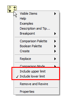

In Range and Coerce, can the upper limit and lower limit be set to equal to greater than and equal to less than, respectively?
I noticed that the in range and coerce function operates with less than or greater than at the moment.
Is there any way of changing this equal to less than or equal to greater than?
Many Thanks

Right click and change the settings:
Regards, Jens
