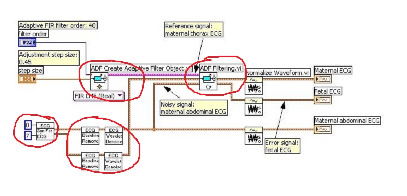

In which toolkit can I find the following components?
I am currently using LabVIEW 2014 and I'm looking for the following componets (encircled with red). Which toolkit(s) should I go for?

The ADF vis are part of the Digital Filter Design TK
The others look like user created sub.vis
(2,874 Views)
The others could be part of the biomedical toolkit.
https://forums.ni.com/t5/Biomedical-User-Group/ct-p/7002
