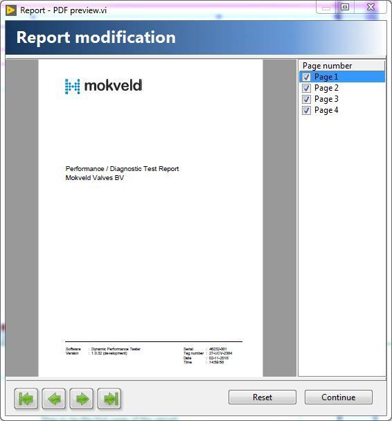

Thank you for the replies, but I need something else. The program generates a multiple page pdf report from a test. After it has been generated I want to be able to remove selected pages from this report (and I want the user to do so). I now have a VI that loads the pdf, shows it to the user and let him/her select the pages to keep/delete. Then the final report get page numbers and is saved in the final location. See the attachment, therefor I need the report to be displayed inside my program.

Hi Jeroen,
what about using preview images for that selection dialog? No need to use .NET in that VI at all…

Hello Gerd,
And how should I do that? I use the pdf Toolkit from Carya to create the pdf report.

Hi Jeroen,
I don't know about that toolkit.
Does it allow to create images for each page too?
Otherwise there are (free) commandline tools to convert PDFs to images…

@GerdW wrote:
Hi Jeroen,
The Toolkit allows to create a PDF document pretty similar to what you can do with the Report Generation Toolkit for Excel and/or HTML So you actually define where to put which text or image into the document and the Toolkit then generates directly the according Encapsulated Postscript format to create a valid PDF file. Pretty nifty and without the need for any .Net or ActiveX component. However the version I used doesn't have an option to also generate previews as it is not a renderer at all, so can't render the PDF document offscreen to create such a preview. And I would think that creating such a renderer in pure LabVIEW is a pretty nasty task to perform.

Thank you all for the replies.
For now I will check for the plugin to be available, if so the option to preview becomes active, otherwise it will be skipped.
I'm not so sure it will be that simple.  Using ActiveX requires property and invoke nodes to call the methods in the DLL.  If the DLL is not installed, you'll end up with broken property nodes and missing DLL errors that will render the application unusable.  If you add this functionality to your code, you should make sure that Acrobat is installed thru the use of a custom installer
