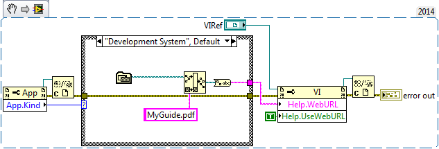

A colleague, certified LabVIEW architect, gave me a work around. Here is the text of his response:
"I did a quick test and got the application crashing too even though the pdf file is copied into the data folder of the executable as it should.
One workaround I found is to switch from "local file help" to "web-based help". You can then use a property node to redefine the help URL as being the applicationfolder\data\file.pdf."

Your CLA colleague is correct. That is a great workaround
