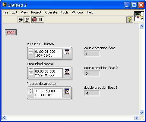

As an attachment, I am posting simple example, that is also shown on a picture below. Set of 3 controls shows result of new control put on a panel, that wasn't touched and 2 other controls with pressed buttons, up or down. As you can see, walue of 00:00:00,000 (this time I didn't remove date time and the fraction part) in the background equals to 01:00:00.

Your example hasn't changed how the control work. Yes, if I put 00:00:00 or 00:00:00,000 into text field, pressing up will give me 00:00:01 but only until I don't reach value of 01:00:00.
Anyway, as I wrote above, I've found solution that satisfies me.
