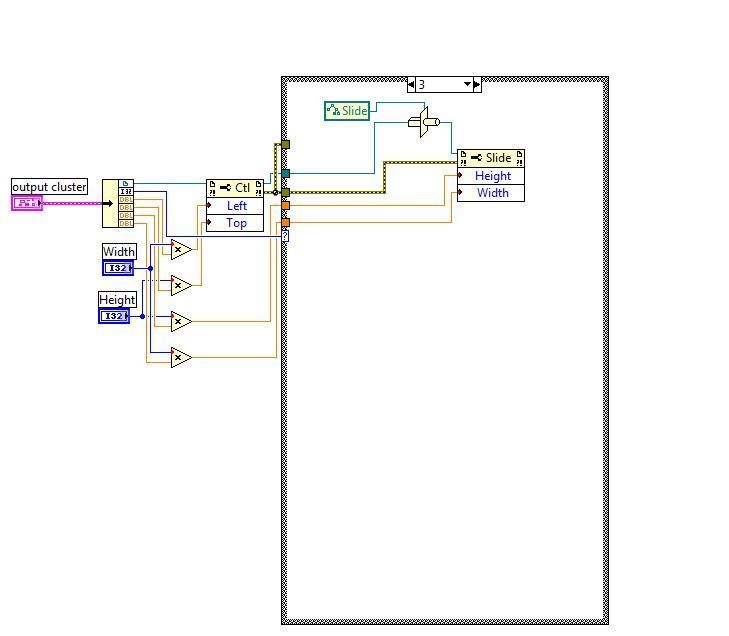

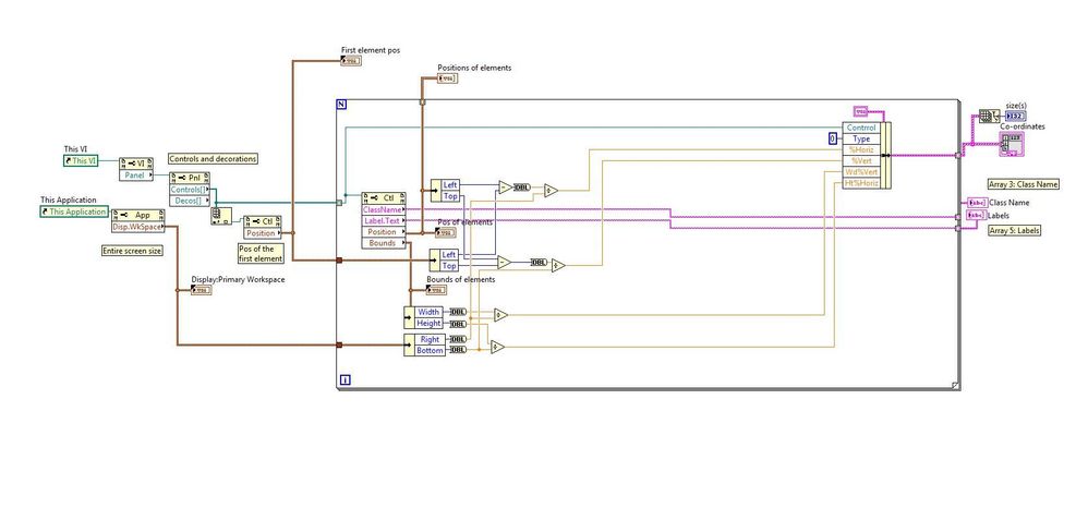

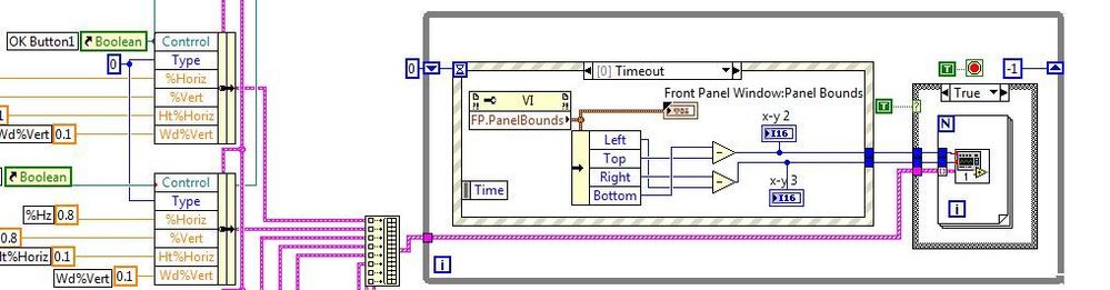

Getting the ratiosGetting the ratiosMultiplying the new ratioMultiplying the new ratioUsing the subVIUsing the subVI
