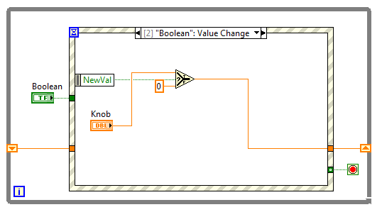

@shadymohamed wrote:
P.S. I only attached the vi for illustrating the idea.
What have you tried?  I'd suggest an Event structure and, perhaps, a shift-register thrown in there.
Jim

The event structure has a value-change event for Boolean, where it puts the new Knob value onto the shift-register if Boolean is True.
Jim
Just move that boolean terminal to inside of the event case.  That way you know you have the latest value of the switch.

You missed the other Event case (and a few other things):
The first image I posted is a VI Snippet.  You can drop it onto a Block Diagram and it'll be converted into LabVIEW code.
Jim

Accepted by topic author shadymohamed
You only care about how much the knob changed.  Therefore, you need to subtract the old value and the new value to get how much the knob changed.  Then inside the case structure, add that difference to your value that belongs in the shift register.
