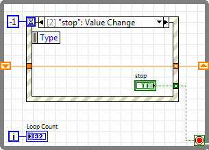

Stop Event Case:
Message 9 of 11
(6,274 Views)
  • You should initialize the shift register with the start number (e.g. zero)..
  • Three is a +1 primitive (increment), use it.
  • Shift register and indicators should be I32 (blue), not orange. You are dealing with integers here.
  • hardwiring a -1 to the timeout seems useless, just delete the timeout case instead.
  • You don't need to wire a FALSE in the other cases going to the conditional terminal. The tunnel is set to "use default if unwired", so you can leave the tunnel in all other event cases unwired.
  • Wire the indicator terminal before the event structure so it correctly resets when the program starts even if no events got fired yet.
Message 10 of 11
