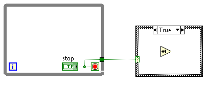

Since you want it to only increment at the very end of the while loop, why not simply wire the case structure to the stop boolean, as well?  That way it will wait until the while loop completes AND only executes if the stop button was pressed.
Other more complex options are out there.  But why not exploit dataflow to simply fix this issue 😄
EDIT:
Do you mean you want something like this?
WHEN the while loop stops and IF the stop button was pressed, it will increment.  (Assuming you wire something to the increment function).

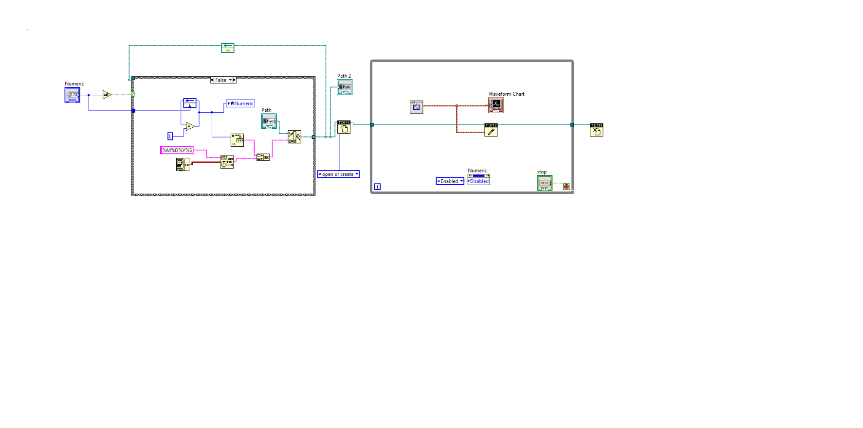

Folks, thanks for your prompt response.  I appreciate.  I decided to just create a simple vi that kinda replicate my main vi, and what the problem actually is.  However, the attached simple vi doesn't successfully run when you click on the Ctrl + R to start the application, but it does illustrate my question much better, in the sense that when you start the application, the value shown on the numeric control immediately increments by "1".  My question is how can I make it not increment by "1" when I just press the Ctrl + R, but should only increment by "1" when I stop the application.
I hope am able to ask my question clearly now.

Below is the screenshot of the vi

You have written the code and you don't want to see the result. If this what you expect, why don't you put the increment after the while loop?
