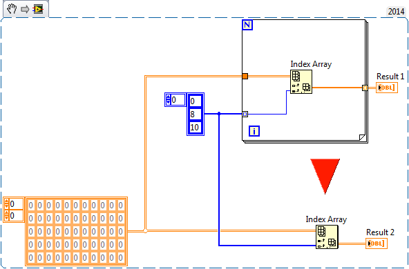

Hello all,
Is there is any way to get some columns/rows from Index Array without using For Loop?
I think, if we can pass group of index values (or) Signal value to Index array then more useful in some cases.
Index Array with group of index values at once.

Hi Munna,
no, at the moment it's not supported. You might create a new idea in the LabVIEW Idea Exchange!
I don't think I will support this as
- you have a working solution using the FOR loop
- for a fixed amount of index values you can increase the IndexArray node to have more outputs and combine it with a build array:

I understand it will be a one shot operation to get all the index values required. You can create your own VI (May be a polymorphic VI), but I am not really sure in which aspect you refer it will be useful. By performance? or Diagram space?. I am just curious to understand.

There is no reason not to use a FOR loop. They are very effcient structures.
Even if NI would create such a function, it would not be more efficient, because it would still need to do the same thing.
If you need this function often, make it a subVI (containing a FOR loop). You can even inline it to make the call overhead negligible.

Hi GerdW,
Here, Column index  will change always so, that’s why I have not used Build array.
If onetime we get all indices then easy for programmer (instead of creating own logic).
