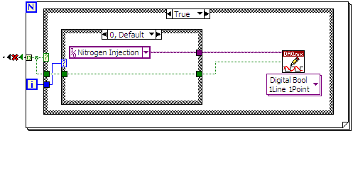

Thanks for that Jeff,
Can you explain what happens here?
To me it here it looks like they are just changing one port.
(3,035 Views)
in Pseudo code:
For Each boolean in array
If Boolean is true chose "i"th task and set the line high
Else : (Can't Tell)
Repeat for next boolean in array.
(3,031 Views)
Sorry,
My question was meant to be about what happens at the DAQmx Write(Digital Bool 1 line 1 point).  A single boolean goes in.  Presumably only one port on the hardware device is changed with all the others remaining as they were.  This is what I am trying to achieve.
It would be good if I could use this by progammatically making up the input task to this from an index whatever else is require to make the thing know which device is being accessed.
