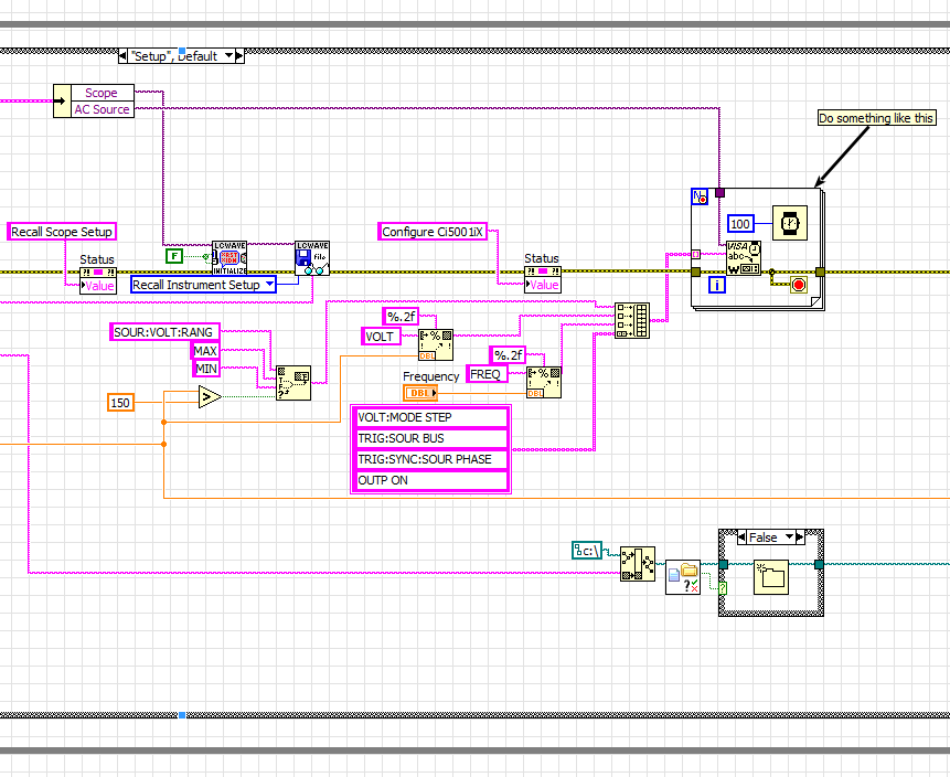

I am not sure why you are so hung up on using a local variable to send sequential VISA commands.
Here is what I do:
That sends 7 SCPI commands to my AC source with a 100mS delay between each command sent.
