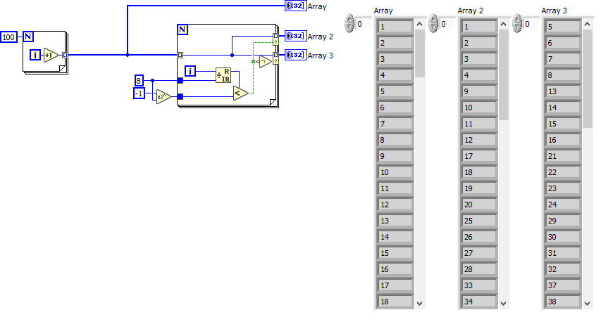

There are many ways to do this. In newer LabVIEW versions, you have the conditional tunnel, so that would give a simple solution, e.g. as follows:
(3,472 Views)

I don't think you'd get 2 groups of 50.  100 is not divisible by 8.  Because of your 4 ON, 4 Off pattern, your first group will have 52 numbers, your second will have 48.

Another variation using Reshape Array and conditional concatenating tunnels.
(3,446 Views)
That only works if there is no remainder for the division, else the last elements will get truncated. My solution maintains the pattern irrespective of input size and will create unequal output sizes if needed. Probably a more universal solution. 😄
