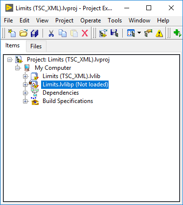

From reading the thread you linked, it looks like a class inheritance issue. The child class needs to be inherited from the Parent lvlibp (PPL), not the Parent lvlib (lib). If it is derived from the lib, then LabVIEW will prioritize loading the lib, and not load the PPL anymore, as shown in this screenshot from the thread you linked.
Unfortunately, we cannot see what's inside of "Dependencies" here. I guess Limits.lvlib showed up there, which should never be the case. If so, Right-Click » Why is this in dependencies, and then replace all calls to the lib with calls to the PPL.
