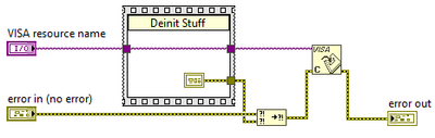

And to answer your original question...
deinitialize functions should always ignore upstream errors, and generally should not produce errors on disconnect. Why should I care if my VISA Close function returned an error? AFAIK it only returns errors when the reference is invalid... in which case, it's likely already closed. If it disconnected during a write, the write function should return the error, and the Close shouldn't overwrite it.
If you read the Help for VISA Close and Close Reference, you will see they both have the following line in their "error in" description:
This node runs normally even if an error occurred before this node runs.
In other words, your Deinit functions should just work even if there are upstream errors.

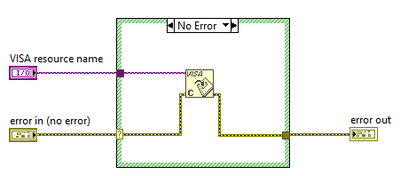

This is a bad way to code:
You do not need the enclosing Case structure. In fact, you generally don't want an enclosing Error/No Error case structure (see NI's Darren's presentation on "An End to Brainless LabVIEW Programming").
Here's how you write a Deinit subVI:
Note that Deinit Stuff happens regardless of upstream errors, then VISA Close does its thing. If Deinit Stuff generates its own errors, it adds them to the Error wire, but upstream errors take priority.
Agilent drivers likely implement their Close functions correctly (I just checked 4 different ones and they are all programmed correctly). Any manufacturer-provided functions that are wired the first way are simply wrong, but I bet most are wired up correctly.
Thus, if your Close functions are programmed correctly, they will work fine regardless of upstream errors.
