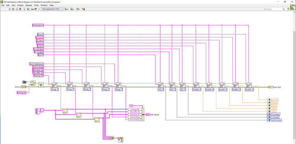

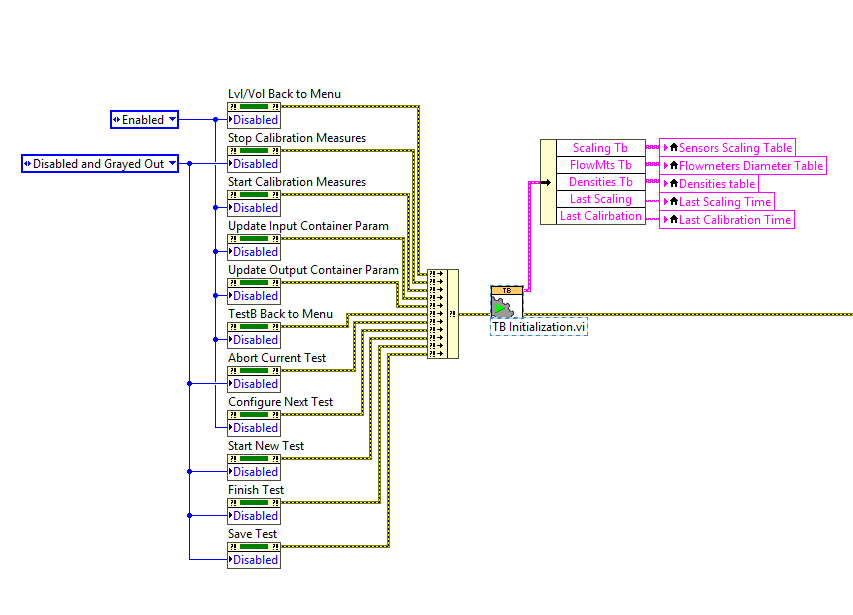

I'm trying to design an initialization subVI for the GUI of my top VI, but I'm not being able to create an array of refnums with the controls of the front panel that I want to initalize to pass it to the subVI.
Then I'm doing it like this right now:
Top Level VITop Level VI
Initialization SubVIInitialization SubVI
Updating the controls, via property nodes and local variables, in the top level diagram because I can't create arrays with the top level FP controls that I want to pass to the SubVI. There is a cleaner way to do this?

1. Create a TypeDef cluster of references (create the appropriate number of references, by control/indicator type, and name them to match the front panel objects).
2. use your refnum constants on the front panel to populate the typedef cluster using Bundle by Name.
3. Now you have a cluster of refnums which (using Unbundle by Name) are associated with front panel objects using meaningful descriptions.
Beyond the initialization step, this cluster of refnums can be passed in to any GUI update subVIs you wish to design... enable/disable/hide/show controls and indicators based on the current state of your GUI.
