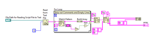

I have a comma delimited text file which is initialised into an array using the VI below.
The issue is that I have to place additional commas in order to make the array larger to provide additional empty columns.
For example:
Dog, Cat, Rabbit, , , ,
This script provides an array which is 7 columns wide.
Is it possible for the initialization of the array to be formatted automatically with LabVIEW functions without having to use additional commas in the text file to be set to 7 commas?Capture.PNGCapture.PNG

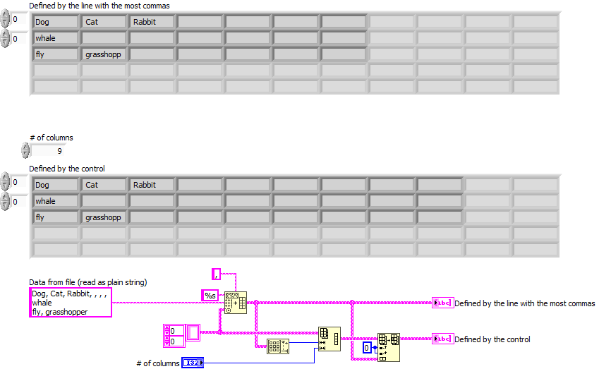

Accepted by topic author neunited
"Read from spreadsheet" file will give you as many columns as defined with the line containing the most commas. If you want more columns, do as suggested.
("read from spreadsheet file (string)" replaces the "spreadsheet string to array" in the image code)
Message 8 of 12
