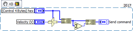

I've tried your suggestions but still to no avail. The VI i attached is what i've done and logically it should be right. However, i'm only able to write the command to the device but i can't read a reply. Below is my VI and could you please help me check if i'm missing out anything?
@GerdW i've tried using only the manufacturers software and it could work there however, when i downloaded a software called TMCL - IDE, it couldnt set up a connection with the device itself at all even though it's suppose to.
The is one of the instruction for the binary communication format and from what i'm seeing its the same as output to my vi. A timeout of the read vi has been stopping my program and i'm not sure if its taking too long to read from the device as its baud rate is suppose to be at 9600. I've research and think its should be okay to read 9 bytes in 9600 baud rate but i'm not sure.

Hi Jarrold,
why do you use InsertIntoArray when you want to build an array?
Your "Control 4 Bytes" doesn't fit to the ROR description in your manual snippet.
The timeout occurs because you don't receive an answer from your device (most probably)…
Reading 9 bytes at 9600baud just takes ~10ms.

Hi GerdW,
I didn’t notice that inserting into an array is different from building one. I thought both output would be an array so it wouldn’t matter.
The control bytes should be at 01 01 00 00 + 4 bytes value + checksum for ROR instruction to address 1 right? (Just checking if I’m understanding the snippet wrongly)
If yes, I did tried that instruction but it still didn’t receive a reply 😞
i was suspecting maybe the baud rate differs from device and host but I can’t seem to establish a connection and I’m lost. Is there any other info I can provide you so it might be helpful?
Jarrold

Yes they both output an array.  But 99% of the time you probably need Build Array.  The other 1% of the time would be Insert Into Array.  That's because 99% of the time you are putting elements at the beginning or end of the array.  It is much easier to do that with Build Array then doing all the extra work you need to do to figure out where the end of the array is so you can "Insert" it there.
Are you sure your checksum is correct?  It looks like you are just summing the bytes.  That may be fine, but many checksum protocols are much more complicated than that.  What does the manual say?

Hi RavensFan,
Thank you for the insights, i'll change the insert array to build array.
For the checksum it is stated that it is the sum of all the other bytes using 8-bit addition.
With that said, say our velocity is 10000, the send command should be 01 01 00 00 00 00 27 10 39 which is the same as the example given in the manual when
Module address: 1
Instruction: 1
Type: 0
Motor : 0
Value: 10000 (00 00 27 10)
Checksum: 39
Message 10 of 10
