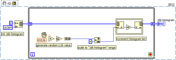

Hi Minikisscool,
make your own histogram function without using big arrays!
I guess your "Avg Energie" range is known before the measurement. So set up your histogram (range and number of bins). With each new "Avg Energie" value you only need to increment the corresponding bin…

My problem is performance for solution 1.
Each mean are put into an 1D array. With time, the size of the array is big (more > 100k or more)
It's right that input is U16 <0 - 65536> and i want to fit theses values into a 16k or 32k histogram. 16k first.
and my input values will varies between 0 and 65536, so all range of U16
I can't attach my VI, because values comes from a FIFO from FPGA.
make your own histogram function without using big arrays! - how do it ?

Hi cool,
like this:
(3,996 Views)
Many Thanks, it works fine 🙂
It's the first time, I use this structure
