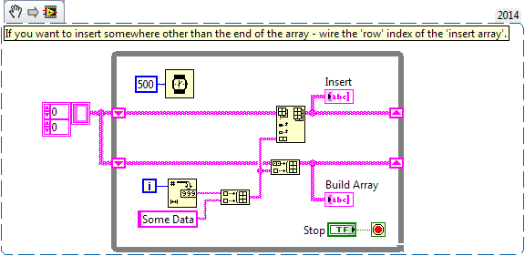

You posted a picture of your code, that's not very helpful as I can't run it to see what happens.
Are you just wanting to add data to the bottom of the array (i.e. new rows?). You will definitely need a shift register as you need to store the value of the array between iterations.
You can use either of the following:
(it's a VI snippet, so you can drag it into LabVIEW 2014 or above)
(blog)

Thanks for quick reply, unsure what has happened but it is a code snippet only shown as icon?
I have modifed code to include yours but it auto indexs through the rows,

What do you mean by 'auto indexs' - you have no auto-indexing terminals?
I really have no idea what you're trying to achieve with this. You initialise the array to a certain size, but then you keep inserting elements (which will make the array grow).
Also, you should use the index *before* your case structure, since the array is 0-indexed. That's why you have the blank row at the top.
