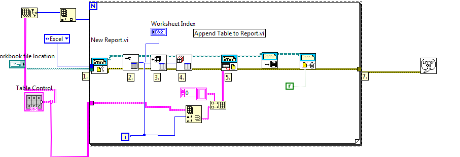

2.pngwhere exactly to add the loop,because i already use it but i didn't succed,maybe i missed something

Hey achfire,
I made a few edits to your code, and it appears to work now. Generally speaking, we don't want to open and close references or files within a loop. Instead we can open the file once, read/write to it in our loop, and then save/close it when finished. I also removed the index array function, as for loops can auto-index at loop bounaries. (This also prevents us from having to wire a number of iterations into the "N" terminal.)
Let me know if this helps!

What is the purpose of the 1-D string array constant that is empty?  It looks like it is just there to turn the 1-D array into a 1 row 2-D array.  If so, you just need the build array function with only one input and get rid of the empty string array constant.

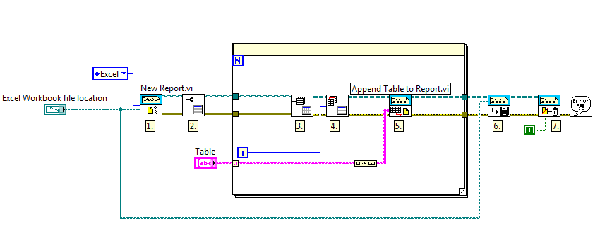

Hi achfire,
Try modifying your code to look like this:
David R
