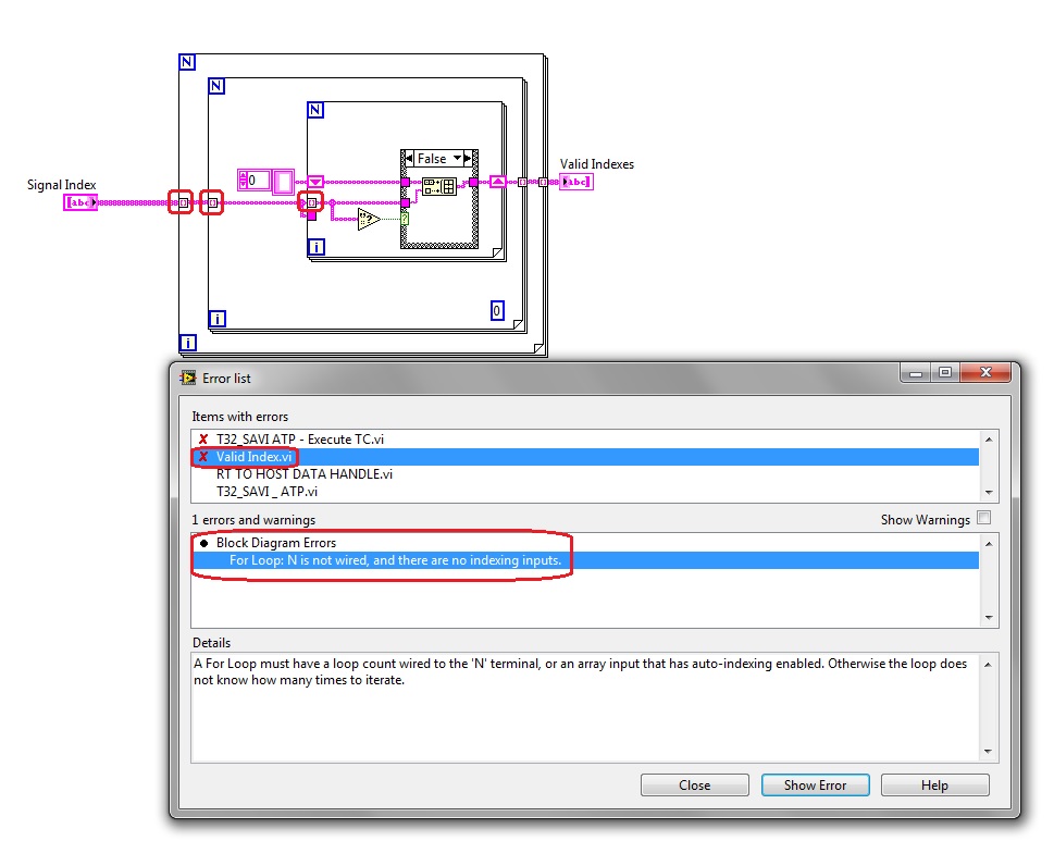

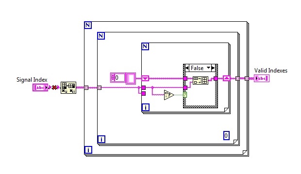

Inserting a Transpose 2D Array into a 3D Array & Undoing keeps the VI still in broken state even though there is no error.
  • Open the attched VI (LV 2010)
  • Insert Transpose 2D Array function between the Signal Index 3D Array & the outer-most For Loop
  • Now, do Ctrl+Z & see.
  • The VI is still in broken mode, even though there is no actual error.
  • Click Run button once to get rid of this buggy error.
Can someone verify if this bug is still there in LV 2014/13? That would help us get a CAR#.

This may be a bug in the 2010 version. I have tested in 2012 and seems to be working fine (No broken arrow after Undo).

Hi parthabe,
with LV2014 that problem is gone.
So update to a more recent LabVIEW version… 😄

Ya.. I checked it LV2013, and it didnt break there. And seeing Anan'd reply, seems LV2012 also does not have this issue. So, can anybody check in LV2011? Just curious to know...

No problem in LV2011.
