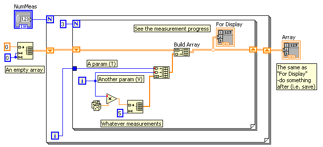

Perhaps you are frustrated seeing the array reinitializing each iteration, showing only the current measurement. Shift registers are your solutions:
Of course, as Jorn wrote, if you have a large number of measurements you should initialyze the array with appropriate number and use "Replace" instead of "Build Array", but it seems this is not your case.
