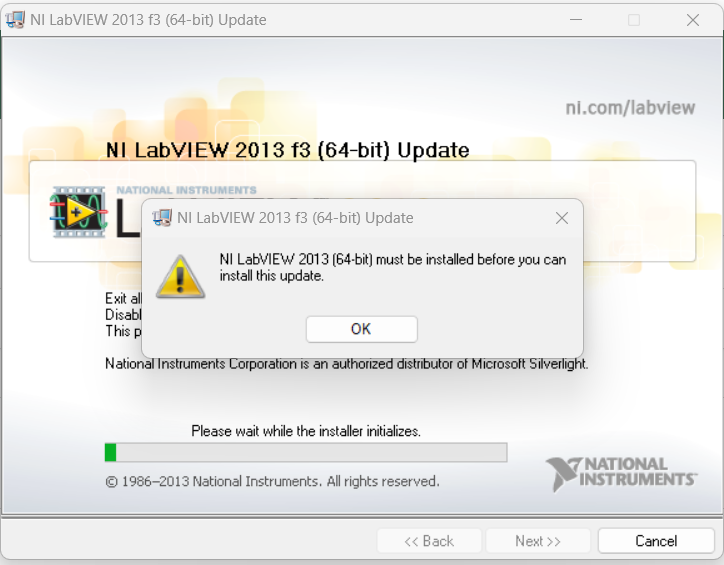

Hello, I am trying to download a previous version of LABView because I need to run a legacy program on it. It is not compatible with newer versions. However every time I download the 2013 runtime installer it only gives me the patch installation setup, instead of the base program setup. I attached the error. Also, the url to where I am trying to download the software is https://www.ni.com/en/support/downloads/software-products/download.labview-runtime.html#359537

Verify that you are downloading the non-patch version of LabVIEW, non-NIPM based installer patches only contain the updated files and must be run on a system that already has the non-patched version of LabVIEW installed.

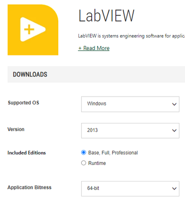

The ni.com download page for the non-patched LabVIEW is the following: https://www.ni.com/en/support/downloads/software-products/download.labview.html#359473 and should display as shown below:
The actual URL for the download is: https://download.ni.com/support/softlib/labview/labview_development_system/2013/2013LV-64WinEng.zip

Okay, I just went through the download of the RTE for LV2013.
There is a error in the download files for the 64-bit version:
If you select the NONE patch version for 2013, you will get the patch installer for f3.
https://www.ni.com/en/support/downloads/software-products/download.labview.html#359471
If you select the patch installer for 2013, you will get the installer for the NONE patched version, f2.
The name of the zip file that you download do NOT match was is in the zip file.

I agree that the file that ni.com points to for the 2013 runtime appears to be the f3 Dev patch and not a LabVIEW runtime. The only file I see on the server is the below EXE and it is for the non-f version of the 64-bit runtime.
https://download.ni.com/support/softlib/labview/labview_runtime/2013/Windows/LVRTE2013_64bitstd.exe
The 2013 SP1 runtime appears to be a f6 version and that should not require any previous version to be installed.
https://download.ni.com/support/softlib/labview/labview_runtime/2013/Windows/f2/LVRTE2013_f2Patch-64...
