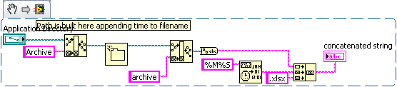

I am using the application directory vi to determine the path.  I have attempted to attach my development code showing this.

Are you creating the "Archive" folder by installing a dummy file there as part of your installer?
If not, you need to create this folder by adding the create folder.vi
Without a valid file path the dialog will open by default.
Hope this solves your problem.
