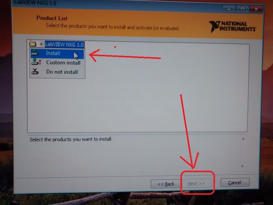

I am trying to create an installer for our group with VLM.
The LabVIEW2017 installer works and has options.
The LabVIEW NXG 1.0 installer shows no options.  I select Install as shown in the attached picture.  Yet it does not seem to stick.  With nothing selected the Next button is not activated.
Has anyone else had this issue and is there a solution?

Hello Mark,
The following forum post explains that LabVIEW NXG 1.0 can be installed via volume license installer but it requires physical media.
NXG and VLM
From <http://forums.ni.com/t5/Volume-License-Manager-and/NXG-and-VLM/m-p/3638513#M511>

We are not planning on officially using NXG for our code until more features are officially supported.  I want our team to become familiar with NXG so that they will be up-to-speed when they do become available.
So for now we will just use NI Package Manager to install.
Installing from the VLM was just a way to make it easy to install licences.
(3,422 Views)
That sounds like the right work around for now.
NIPM Is also in its infancy and the integration to VLM may be unsupported as of the current progress along the roadmap.
