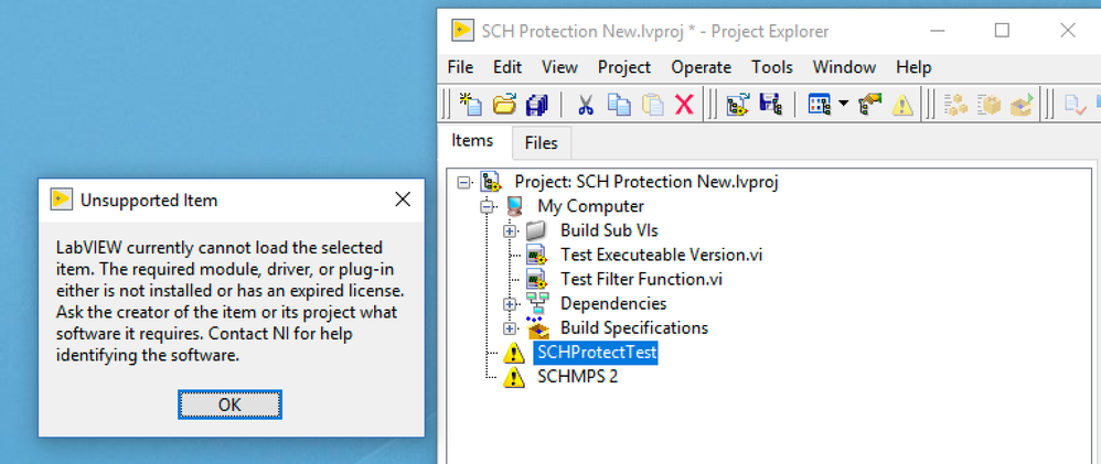

That is my guess here.  I did not have this issue with LV 17 and Win 10.  But I am windows impaired.  So I installed both LV 18-32 and LV 18-64 and as many compilers and FPGA modules as I can.  I then moved my LV 17 project over to this new VM system and opened it.  Under LV 18-64, I get the following:
LV 18-64LV 18-64

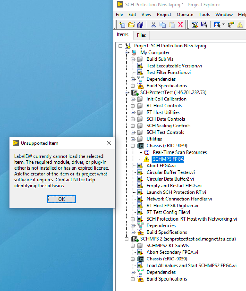

I then open the project under LV 18-32

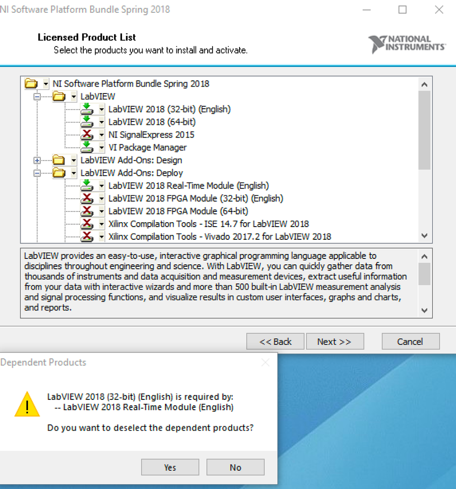

So I go back to my Academic LV 2018 NI Platform Bundle Spring 2018 and select as much as possible.  The first error is that the RT module does not allow selection of LV 18-64
Selecting RT moduleSelecting RT module

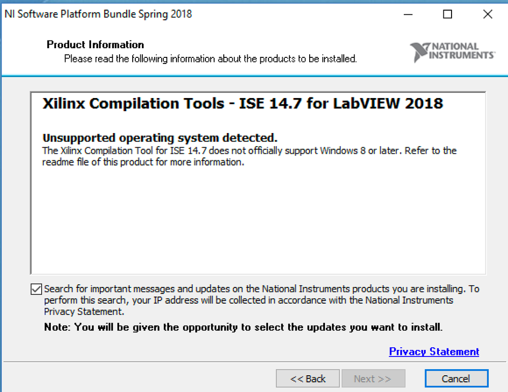

So going ahead with the install, without LV 18-64 I get that the older Xilinx tools do not install.  Fine, don't need them at the moments, so deselect them.
Can't install ISE Xilinx toolsCan't install ISE Xilinx tools

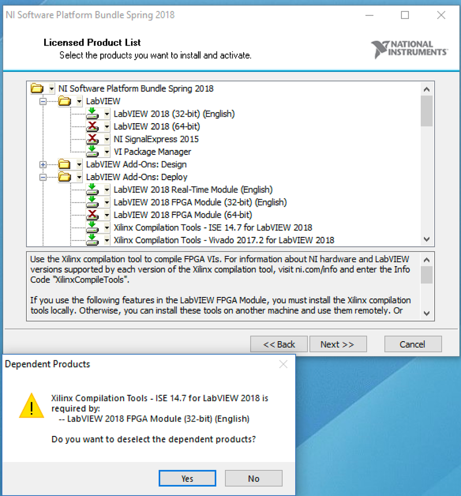

Now I get one last issue:
Now it tells me that the older Xilinx tools are necessary.  The compiler has completed the loop and the Catch 22 is complete.
