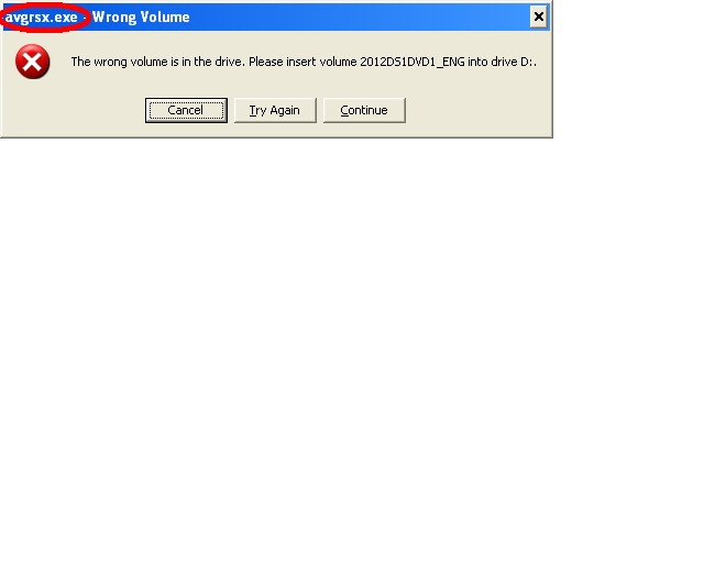

Sorry, no error log to share; but I had the same problem:  Dev Suite installation ran fine up to same step (16 of 18), and then threw a 'Wrong Volume" error saying it wanted DVD#1 instead of #3.  When I put in DVD#1 and hit 'retry', it immediately threw the same error again, but this time asked for DVD#3.  After this second disc swap, the install proceeded, only to throw the same sequence of error messages when commencing to install the very next component.  In my case, it turned out the error messages were somehow being caused by my antivirus software, which I'd neglected to disable during the install.  The key hint was the title on the error popup:  'avgrsx.exe' is a component of my AVG antivirus software.  When I disabled the AVG antivirus, the remainder of the installation proceeded without interruption.  Oops...

For some reason ipoint.exe does the same thing to me, I just force close the ipoint.exe program and let the install continue uninterrupted. I have no idea why ipoint.exe wants the previous disk.
