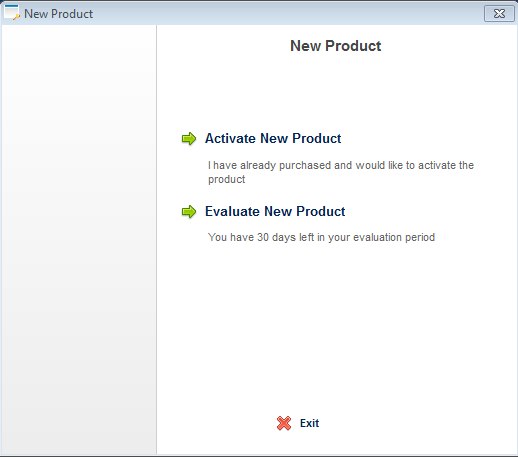

Hello battler,
I ran the VI and I didn’t have any trouble in it, so I want to ask you if you are the administrator on your computer or not, since that is what the error message is saying.
I took screenshots of the functionality of the VI that you send, so you can see if that was the functionality that you needed.
The Error 42 is a generic error, so that is why you cant have much information in the LabVIEW Help.

Thank you guys.
I am using Win 8 and I am administrator.
I had to build VI to exe then right-click "Run as administrator".  Then it worked.
I only had to right-click and Run as admin once then after that the exe runs and opens DLL no problem.
