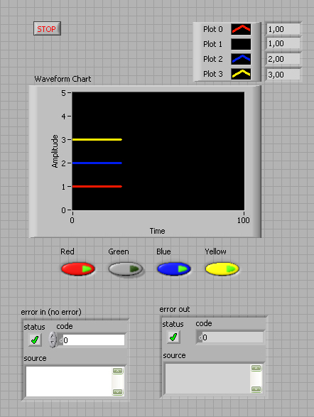

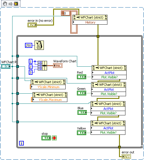

Wouldn't it be more simple to allow the user to choose which plots are seen and which are not? Something like this:
In this example the red and the green plots are indicating the same value, therefore the "user" has decided to set one of the plots he does not want to see as invisible. In this case it is the green plot.
P.S. I have used Waveform Chart in this example, but using XY Graph would involve just the same Porperty Nodes, I believe.
Edit: The VI Snippet tool has "hiden" the numbers to set the active plots because of the WFChrt reference it has automatically added. But the red plot is the no. 0, green - no. 1, blue - no. 2 and yellow - no. 3. So you would have to wire these constants to their input terminals.
