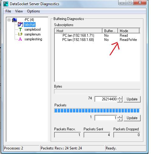

Sorry Althenbach,
I'm found a problem in this program when I use this program in two different Machine A and B.
When I start the conversation at Machine A first, I type "ABC" in Machine A. It successfully shown in Machine B. But when I reply "123" in Machine B. Machine A cant see the "123" message .
Vice versa, If I start the conversation at Machine B first, the message will succesfully shown in Machine A. But I use Machine A to reply. The message will not display on Machine B.
And I found that whoever started the conversation first, will have Read/Write Mode in 'DataSocket Server Diagnostic'. While another machine only have 'Read' mode.
Do you know what caused that problem?? Any solution on that please??

The original code have the same problem too. I not sure is the program problem or my Labview setting problem (maybe I leftout some tweaking?). Because when I run it on same machine it works perfectly.
Is this the problem (picture below)?? Because the first machine who send out message will get the Read/Write Access mode and the message able to shown in another machine. Is there anyway to make multiple PC on (Read/Write) mode??
I have read lots of information but I couldn't figure out the solution..
Hope you can guide me on that. Really appreciate.. Thanks altenbach. Smiley Wink
Message 14 of 23
(2,635 Views)
Looks like a permission issue. Check the "Datasocket Server Manager" settings.
By default, only the localhost can apparently write. (sorry, I am not familiar with all this).

I guess the problem is here... How to give "Write-access" to the second computer?? Can anyone please help me with that??? Smiley Embarassed

I went to DataSocket Server Manager > Permission Groups > DefaultWriters > Add Host > put the client ip address..
I also tried another method too but still not working.
DataSocket Server Manager > Permission Groups > DefaultWriters > Change 'Localhost' to 'Everyhost'.
So did you try to run this LabChat program on different pc?? Is that working for you?
Thanks for your reply and help.
